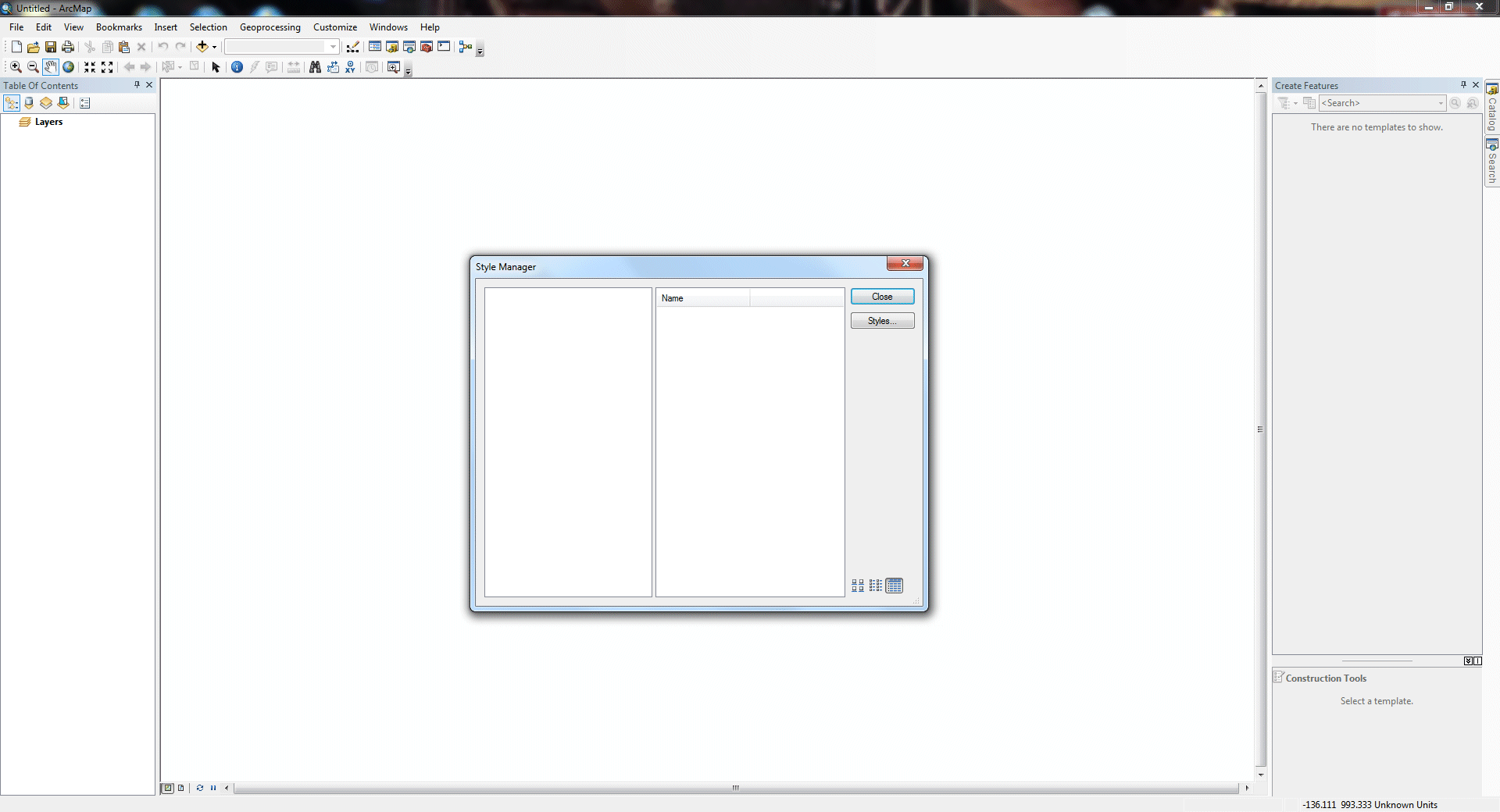

Print screen for your style manager may be helpful.
mattbeamish
Here you go......
thanks for response
Empty Styles Reference Manager ArcGIS 10.3.1
