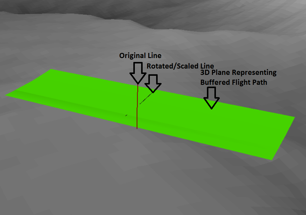

Yes, so I realized after you replied here that I have recently densified the lines every 10 meters for a specific purpose. The "sections" that I am talking about are the sections that are defined by a single "span ID".
You are correct that if I scale and rotate these differently that the lines will no longer be connected. My end goal is to create a layer that is defined by the flight angle of birds across each power line span. The picture below is one span that I manually edited. This is what I want to happen for all of the spans in my dataset. The rotation is based on flight direction of birds and scaling occurs so that the new flight path does not exeed the length of the original span.
Hopefully this helps explain my goals a little more clearly. I feel like it is a pretty unique problem so its hard to explain exactly what I need!

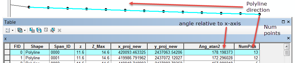

The data are indeed segments  many points for some bizarre reason since they appear to form straight line segments.
I calculated angle relative to the x-axis using

For example your feature FID 1, Span 000  consists of 13 points ( use the FeatureVerticesToPoints tool )  so this file for some reason has densified points along each segment.  No clue how it was generated, but my guess is that the angles that I calculated apply to each of your little tiny segments and under no circumstances should you explode them.  You can generalize the data within each segment ... you could try the Simplify Line tool to get rid of those excessive fiddly-bits.  So in short...I would find out how those lines were generated and why before you get too far on the rotation stuff.  If you want to rotate all the shapes by some amount then that is simple...if features have to be rotated by different amounts, then you do realize that they will in all likelihood not be connected any more.
