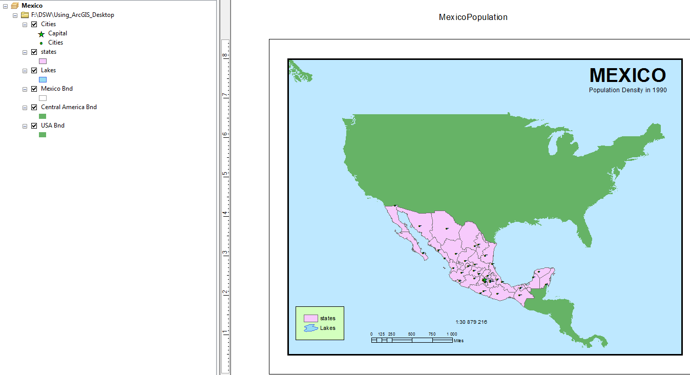

Yes, I have read this link, but I could not find there the answer to my problem. This is the layout view:
AnthonyFarndon
As Joshua says, your df name is wrong.
