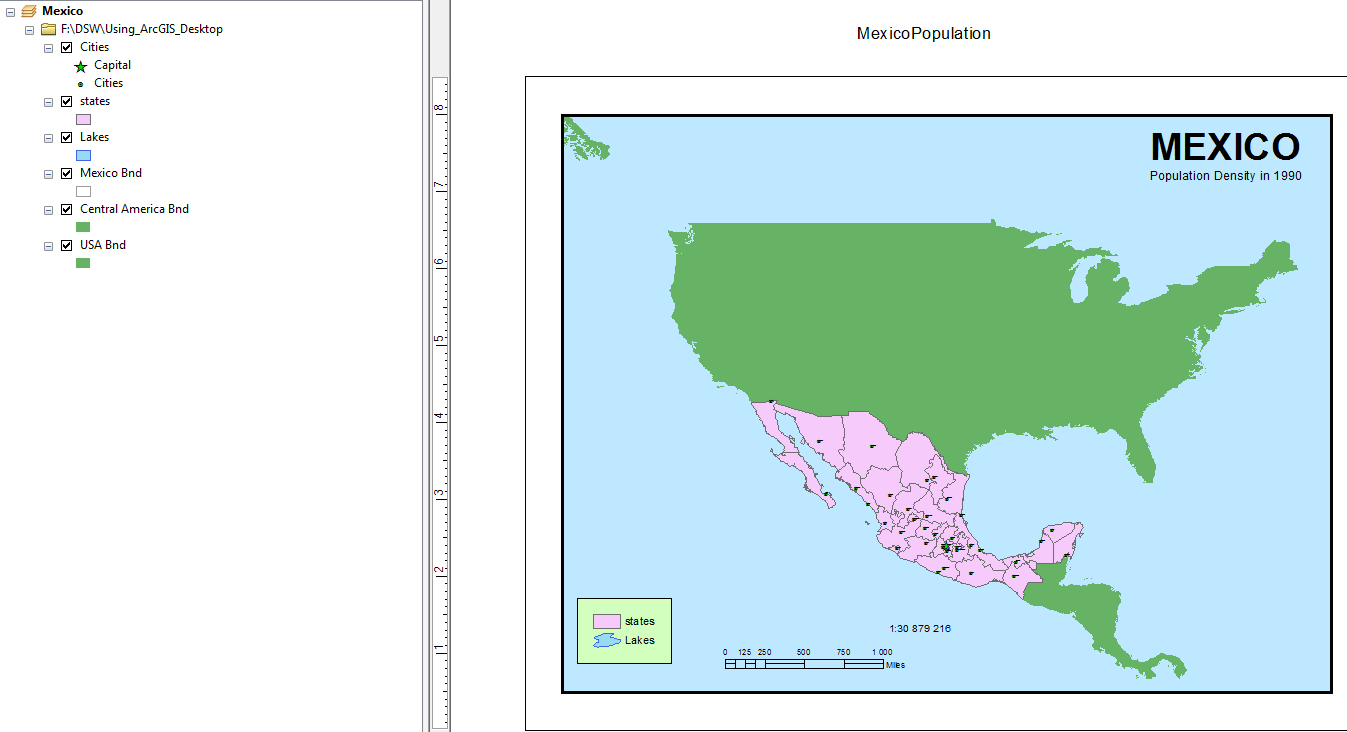

As I have changed the name of shp file -> from States to states and use python to print the name of the layers, I have received the same result as BEFORE the change. So instead of:
Cities
states
Lakes
Mexico Bnd
Central America Bnd
USA Bnd, I have got:
Cities
Lakes
Mexico Bnd
States
Central America Bnd
USA Bnd

is mxd defined as "Current" somewhere? that seems to be the piece that is missing for me... Did you read the link I sent you? The project has to be named as on disk or if you are working interactively, then with the Current keyword.  Also, you are in source view in the table of contents, ... go to the data view (to the left of your current selection) to ensure that the layer is named "states" and not "States"

I do not use CURRENT keyword, because I do not run a script from ArcGIS Python window, but from the PythonWin. Instead of that I put the correct pathfile of the *.mxd file and all *shp. files, which are included in this project.
The layer name is states. And now after loding the script once again, I have received the correct answer.
Unfortunately, the problem with changing the name of the layer states to Stany still remains...

Your data frame name is "Mexico," you are never going to find your 'states' layer if it is nested within your df.name == 'states' statement.
