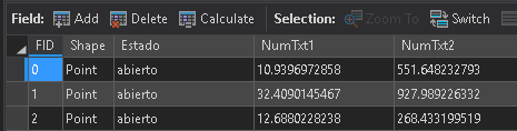

So  I have a shapefile with only text fields:
The last two could be converted to numeric data. As you described I cannot create and proportional or gradual symbology due to the fact that there is no numeric field in my featureclass.

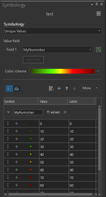

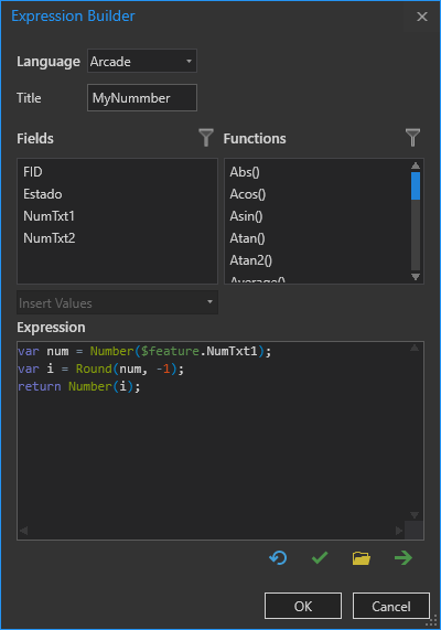

I used Unique values and an expression to convert the text to number and classify it to have less unique values.
and applied symbols to each class:

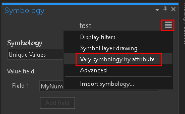

Since I want to change the symbol size according to the "value", I can enter the following option "Vary symbology by attribute":

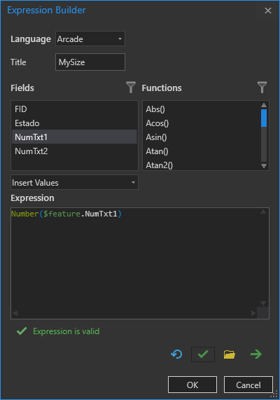

I can define an expression for the size:

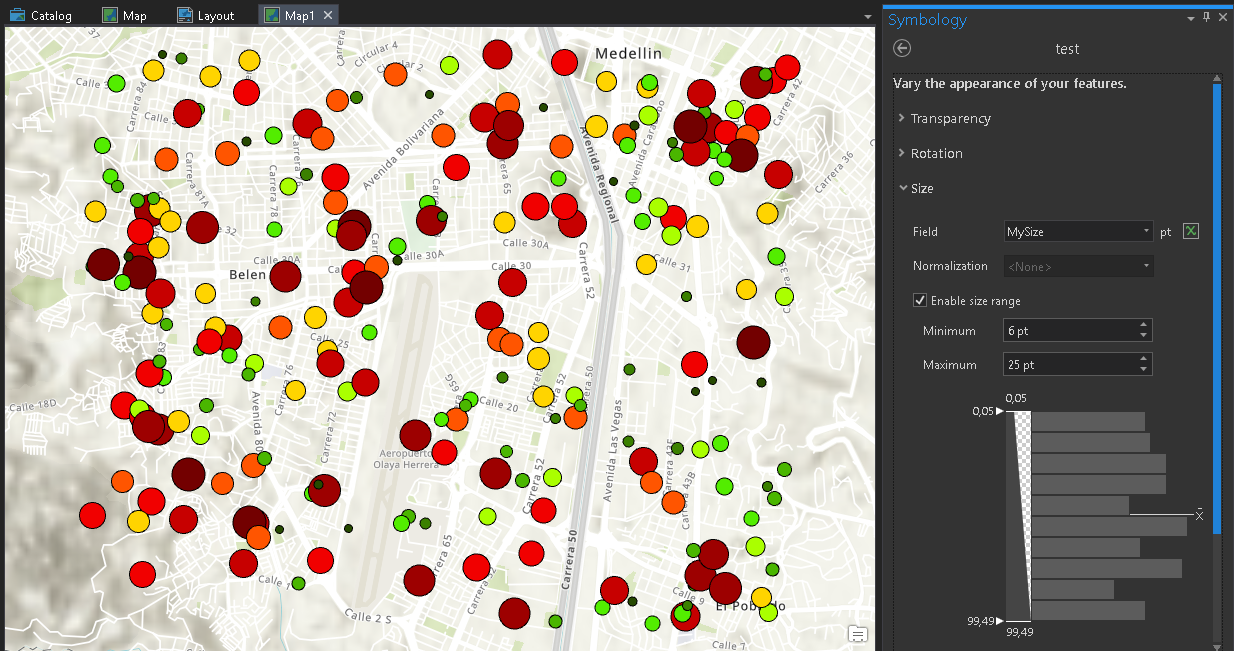

And obtain the symbols graduate by size and color based on the text field:
