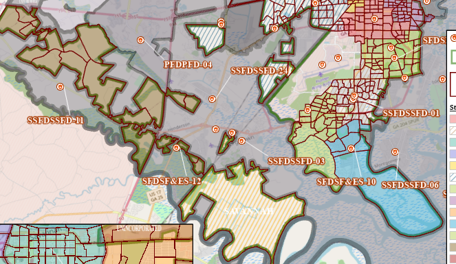

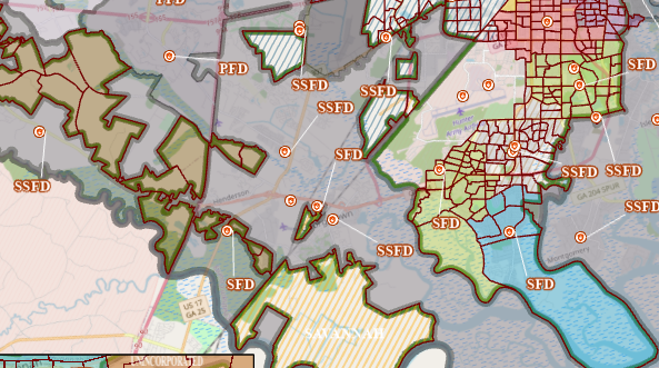

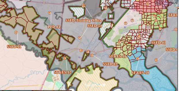

I have pieced together a few things from other posts, but am still having issues. I have a request to replace labels in a map on data I cannot and do not want to edit. I just want to change the acronym used in the data to the desired label.
1) I am currently using the concatenate command, which is working.
Concatenate($feature.FD,'-',$feature.Station)
2) I need to replace the $feature.FD label 'SF&ES' with 'SFD' in that field. When I try the replace command
Replace($feature.FD, "SF&ES","SFD")
It does work but I cannot get the two commands to work together correctly

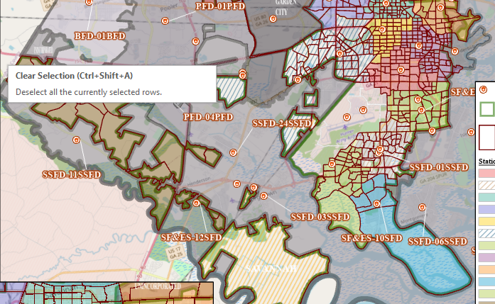

3) When combined:
Replace($feature.FD, "SF&ES","SFD")+
Or in reverse order
Concatenate($feature.FD,'-',$feature.Station)+
