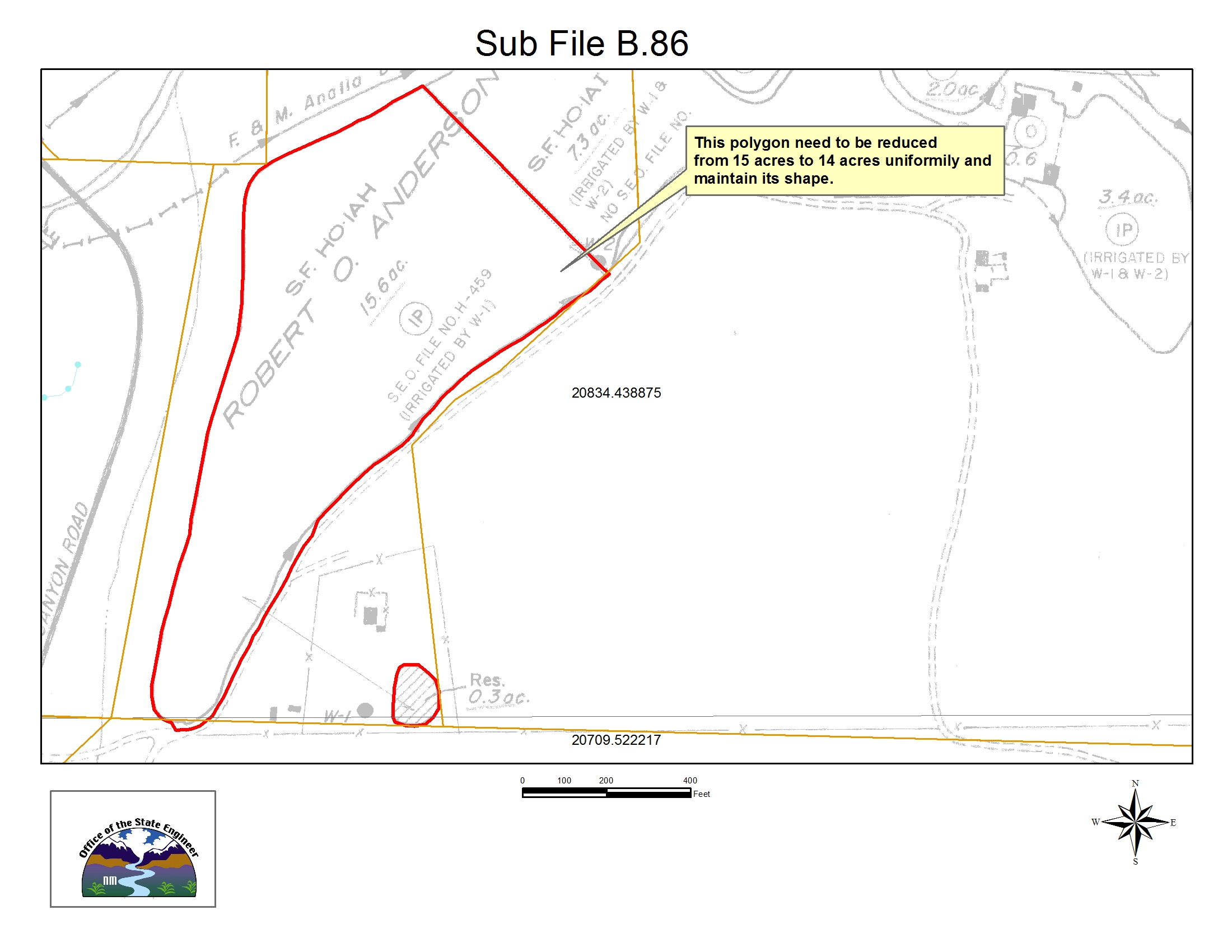

Sorry but I did not place the right question, this is my case:
I drawn a polygon following an hydro survey sheet, said polygon ends with 15.0 acres of land. Now I have to adjust the polygon shape  from 15.0 acres of land to 14.0 acres of water rights, do you think this is possible in ArcGIS?

Thank you for your advice. Basically, I am trying to reduce an existing polygon area from 15 acres to 14 acres at the same time I need to keep its shape. See the attached imagePOLYGON.jpg

as what has been said by Xander and Darren...particular since you imply a spatial shift in the land to water mention.  Is the land adjacent to the water ?(not mention, perhaps implied) Does water rights mean surficial water of subsurface water?

A negative buffer by area should keep the shape the same as one would have to do in the field by producing normals to the original outline and then connecting the points.  The trick is to find the offset distance which produces an area reduction of the desired size.  This has to be done iteratively since it isn't a regular geometric shape.  In fact if the buffer size is large relative to the original shape, you can collapse the polygon in on itself so that the original shape will be unrecognizable.  I can't find any references to current tools except this one
http://www.arcgis.com/home/item.html?id=10b2645c4fcd4daf97100720d417424c
but I am not sure if it does negative buffere
