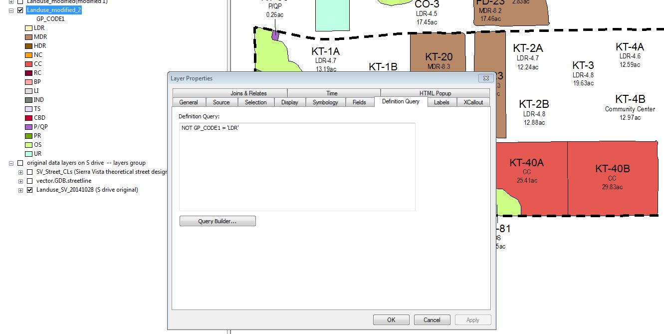

One potential solution is to do a Definition Query on your layer.  In the example below, NOT was used to suppress the display of "LDR" attributes.  Note- in the example image the labels being displayed are annotation that I purposely left on to show where the LDR was; however, if they were labels the LDR ones would not show.
ArcGIS Desktop
EDIT - fixed example image - used wrong field for definition query in original image.

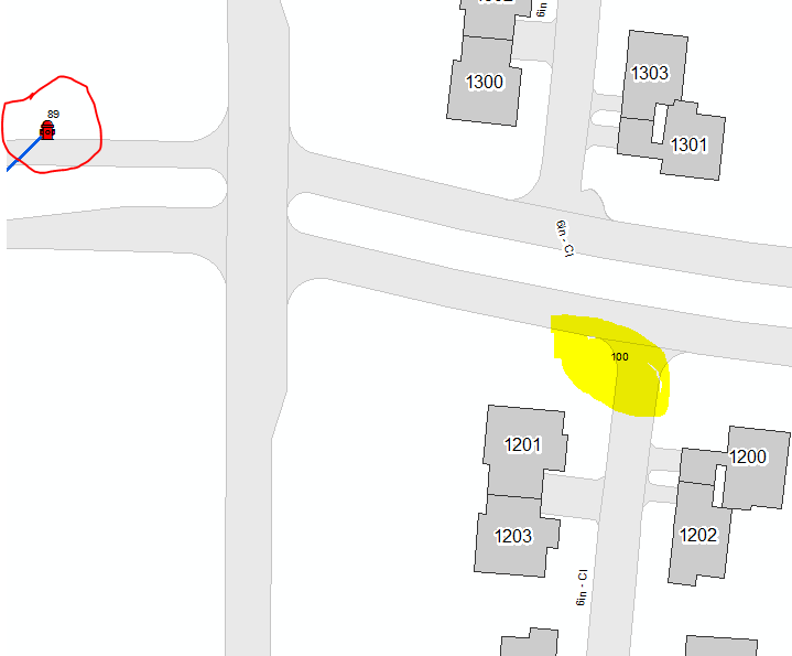

I tried what you gave me but didn't work. Here is a clip of what I need.
In red is a fire hydrant with it's label. The one in yellow has had the fire  hydrant removed (thru symbology) but the label will not go away.
There are about 20 numbers that I would like to get rid of. The numbers are in a attribute field called inventoryControlNumber

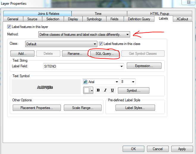

Similar to the definition query idea, you can use label classes to turn on/off labels for groups of features.

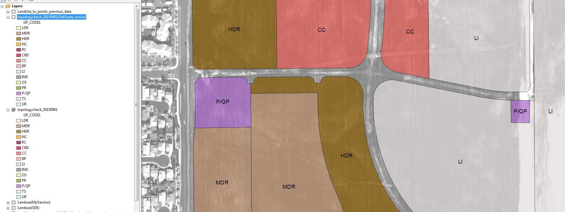

More examples of a Definition Query at work:
All features shown and labeled (starting state)

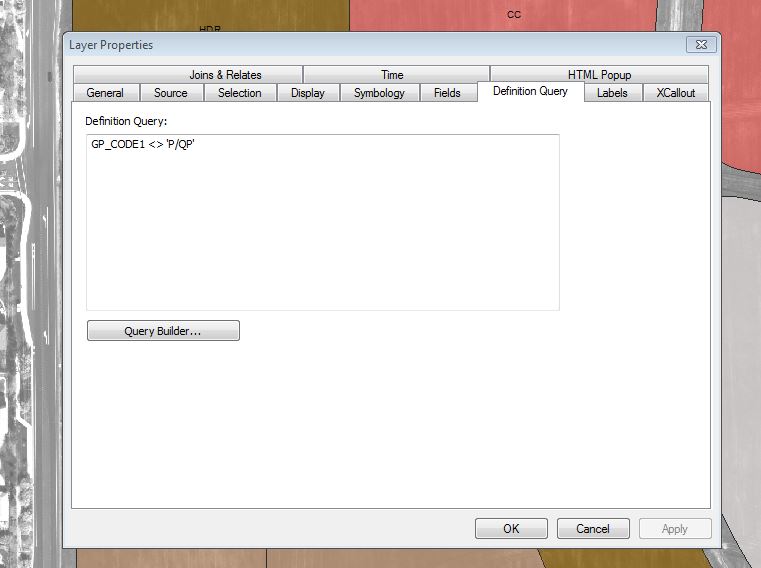

"P/QP" category suppressed via Definition Query.  Both feature and label are now gone.
Definition Query used on layer to suppress "P/QP" category for above image.
