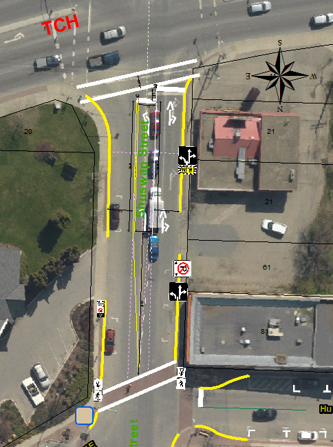

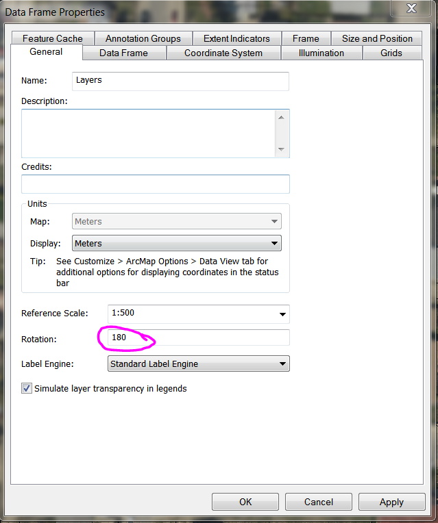

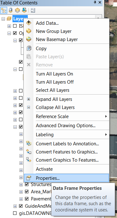

You can rotate each data frame to whichever direction you want. Right-Click on the data frame and select Properties...
Select the General Tab and type the rotation you want (I typed in 180 to turn it so South is at the top of the frame)
