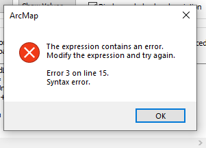

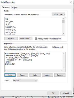

Thank you for your feedback. When I try the expression this is what I get:
[cid:[email protected]]
Any thoughts on what I did wrong?

You can build the label using VBScript this way
Function FindLabel ( [Situs_Num], [Situs_St], [Situs_Unit] )
  FindLabel = [Situs_Num] + " " + [Situs_St]
  if ( [Situs_Unit] <> null ) then
    FindLabel += " #" + [Situs_Unit]
  end if
End Function

Here is the response I get using the suggested code. Can you help me with what I did wrong?
[cid:[email protected]][cid:[email protected]]

I had forgotten that VBScript doesn't have an incremental operator (+=).
    FindLabel = FindLabel + " #" + [Situs_Unit]
  end if
End Function
Is then field [Situs_Unit] a numeric field and does it have a null value or is it a string field with an empty string?
