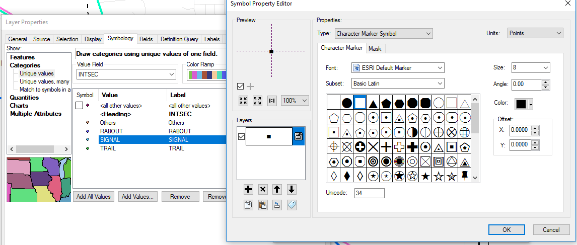

Hi fellow users,
I have created roadway intersection points for a county. I am trying to create a map and wish to display the intersections by type - Traffic Light, Stop Light, All-way Stop, Roundabout, Trail, Crossing. So, my question is where can I find these character symbols in ArcMap?

If you search you should be able to find most of what you are looking for. The only one I could not find was roundabout.
Most look like they are in Transportation.
Go to symbol selector and click style references...
The check Transporation.
Now those symbols should show up in your symbol list.

Thanks, I did this but yes I couldn't find one for roundabout

I found a way for that one.  It might take some work editing a image.
