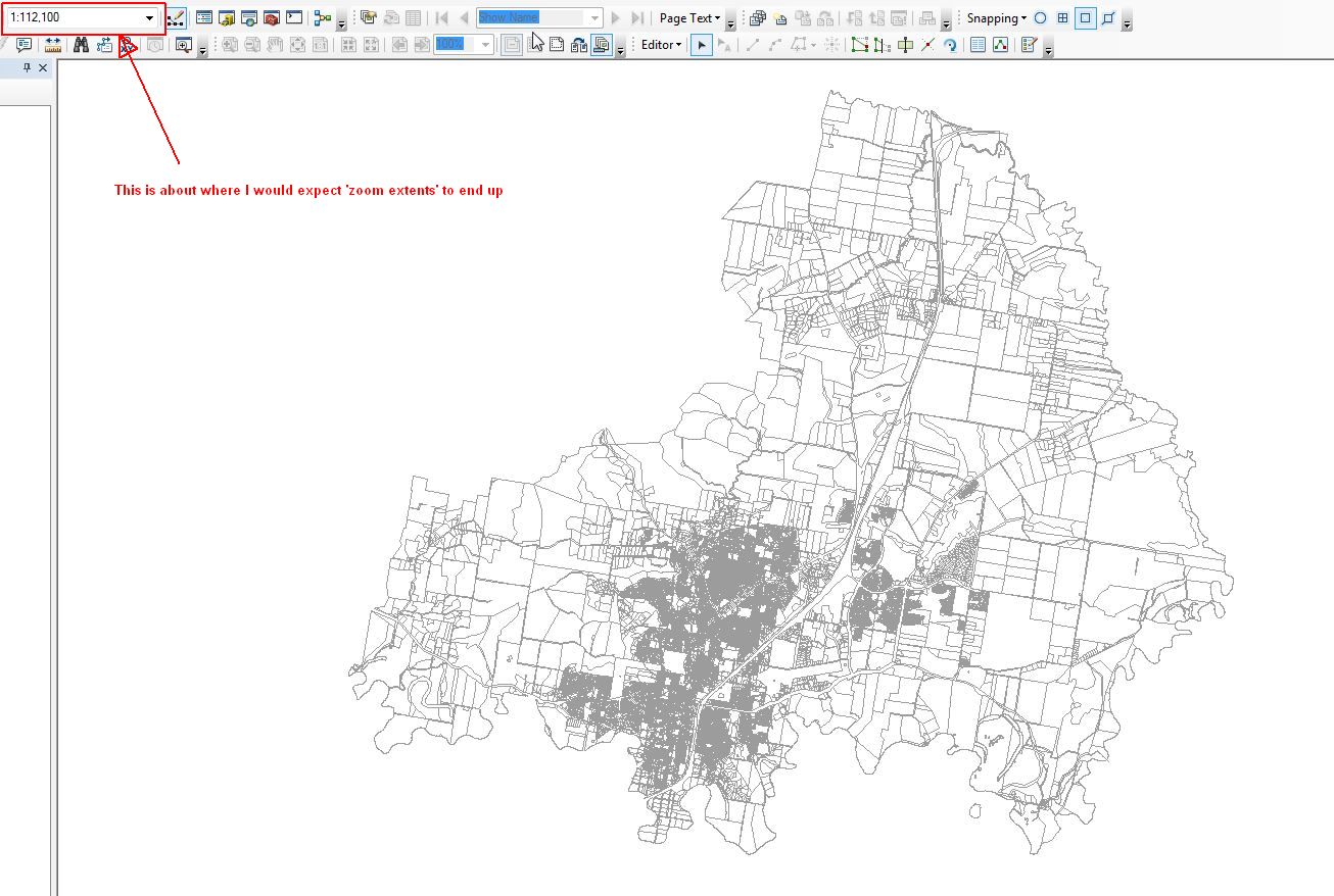

This is where I would expect it to zoom extents:
What I would expect...

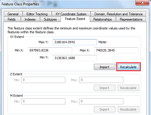

Go to ArcCatalog > Right-click the feature-class > Properties > Feature Extent (tab) > Click "Recalculate". Any change in the extent?
Think Location
BenVan_Kesteren1
Deactivated User
That is interesting, it does indeed update the Min X and Min Y values accordingly. (this dataset is currently locked, so I couldn't save the changes), but it looks like it will do the trick.
