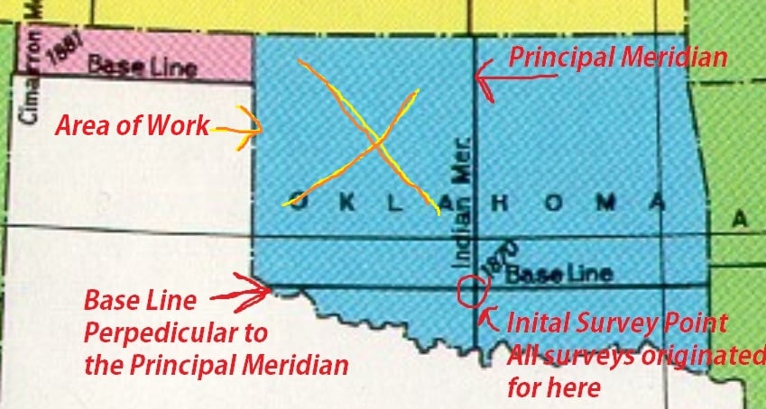

How we are operating now:
My team is building maps in Oklahoma's North West Corner of the PLSS Base Line, and  Principal Meridian.

If you were north of the Indian Baseline and west of the Indian Meridian in Oklahoma. What would you use as your Datum, GCS, and PCS? Then would you use PLSS or BLM Land Grid System?
