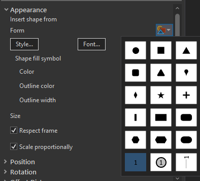

In my symbology, I have a series of marker layers. I'm going to set them each to a text symbol:

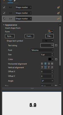

You should be able to pipe in a text string from your data:
I should mention at this point that I don't know how your data is organized. Are these values coming from different fields? I'm assuming they are.
At this point, I've got three text symbols corresponding to 6.0, 3.2, and 1.4:
Not quite there. Now I'll give them each a value for Offset Y.

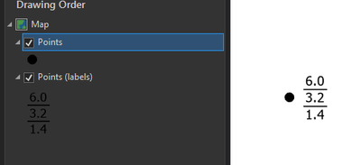

...Except that this is another symbol. So to keep the points, I'll need to apply this sort of symbology to a duplicate layer in my contents. And to get them in the right position, I'll need to adjust the Offset X (or whatever you prefer) to get them off to the side from the point symbol itself.
That's looking like what we want.
