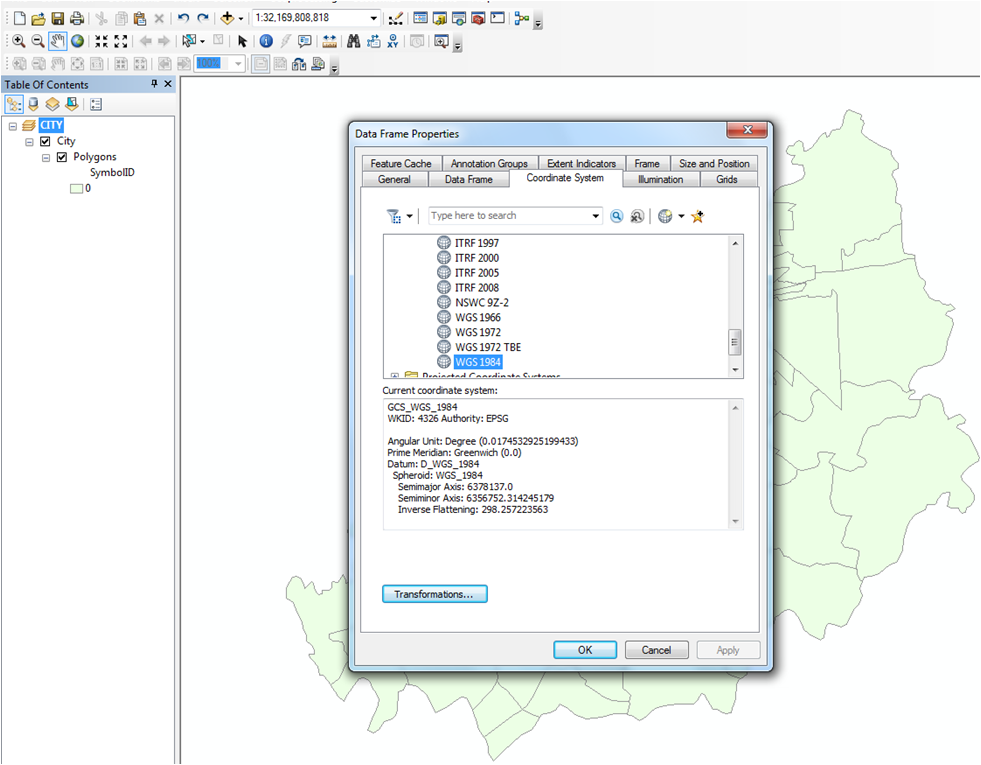

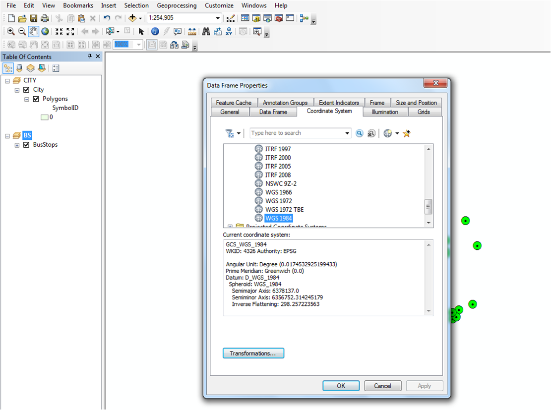

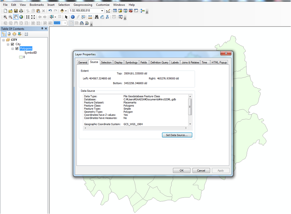

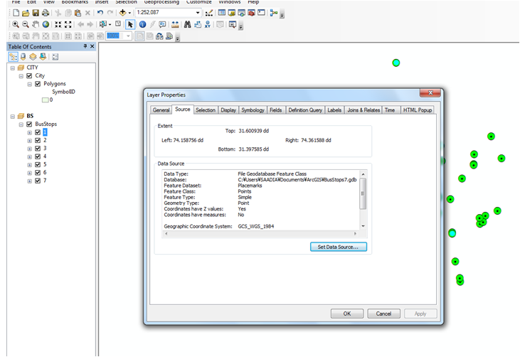

Dan-san Thank you so much for your help. I prepared the separate data frames and found that both the layers have same coordinate systems (as obtained from the same source) , figure1 and 3. But both the layers have different extents, figure2&4. I tried to make the extent same by data frame/properties/ extent/specify extent... but it didn't work. By changing the extent, the layer extent remains the same , it doesn't change.
I have read somewhere that layer extent can not be changed in any way. However i am not sure about it. Anyways i am in view of changing the data source now. Thank you for your kind helpPicture1.pngPicture2.pngPicture3.pngPicture4.png

As I suspected ... your 'numbers' second and fourth image reveal all.  Don't look at the 'words' in figures 1 and 3....  In Figure 2, your extent value number indicate that your coordinates are projected.  They are NOT in decimal degrees...they are projected.  The last one is in decimal degrees.  So your 2nd data set seems to be in decimal degrees, most likely GCS_WGS_1984  Your first data set has been defined as such...probably the Define Projection tool was used in error...and it isn't.  Fix it...do they look like UTM values for your area? I don't have any reference in your part of the world.  In any event, the first file...figures 1 and 2... has been defined incorrectly... they are called Placemarks...Google Earth?  Google Maps?  Google Google and find out what their coordinate systems are
see projection - EPSG 3857 or 4326 for GoogleMaps, OpenStreetMap and Leaflet - Geographic Information Sy...  for instance.
