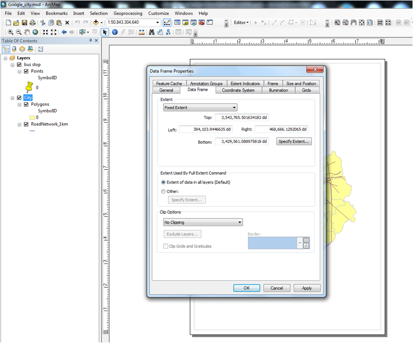

Could you verify the extent of your map and the layer that has been converted from the KML/KMZ file. I could be an issue of wrong extent/projection defined.
Snapshots of the extent and projection system would be helpful.

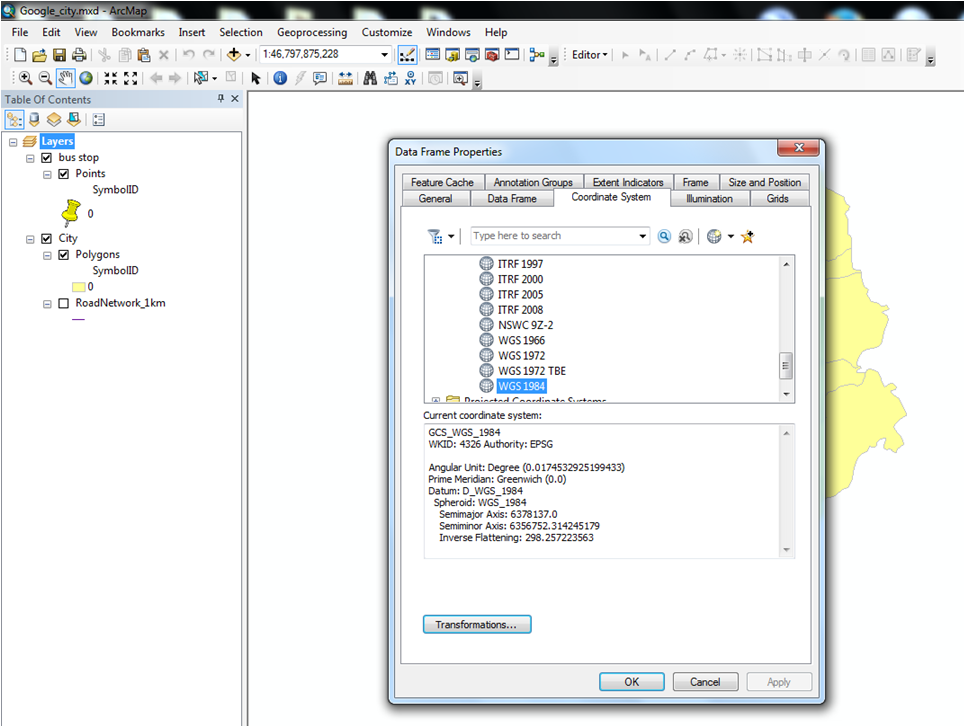

The map and the layer both have the different extent, as you can see from the snapshots. But when i try to make the extent same, it doesn't work. Is there any other way to make them same?
As far as the projection is concerned, i am not sure about it that how to confirm it. I check the coordinate system from data frame properties and its GCS_WCS_1984.Picture1.pngPicture2.pngPicture4.png

I'm really confused from your screenshots. While I see all the layers in the table of contents in one data frame, your screenshots are three different data frame properties screenshots, rather than two different layer properties, and one data frame properties. Somehow, you seem to have your layers in different data frames, one of which is in GCS projection, and the other is not.
SaadiaTabassum
Deactivated User
Thats so. But i don't know how to fix them to the same system.
As far as the screenshots are concerned: i am working with two layers one is city other is bus stop, both the layers are converted from tools/conversion/from kml to layer . The first 2 screenshots show the different extent for both the layers and the last one shows the coordinate system of the data frame from which both the layers do belong.
