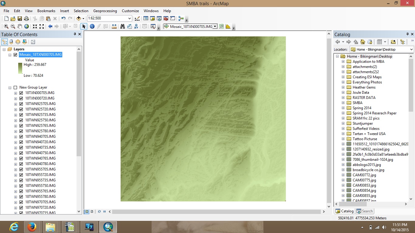

I've been able to create a regional map using DEM tile data and the the mosaic function. Colored it, and added hill shade. Tomorrow I'll look to building in the road and water data. I hope to frame everything as well. Next week I'll head out to the trails and gather the correct GPS data. Should get me close to finishing this project. Recently I found out that the GPS data which we have, although accurate, can't be used because it is not quite up to date with what actually in the woods. It doesn't reflect the current trail structure. Recently, the DEC bought the parcel of land and restructured the trails. Some of our trails were, how you say, slightly outside the parcel box. Our recorded data reflects the pre-restructuring. Perhaps TMI but, a story shared.
Learning how to use ArcMap 10.1 functionally seems to be a one-project/problem-at-a-time sort of process. I'm excited to keep up the learning.
p.s. - any advice on the map is very welcome!
