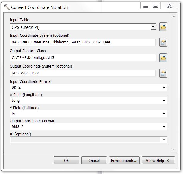

This is the first time I've heard of the convert coord not tool. After an hour of online research, before I posted my ques, I'd not found any mention of the tool. I'd still be hung up without Dan and Neil's replies. After several tries here's the procedure that worked for me:
I projected a blank arcmap to GCS North Amer 83 - I added in my point fc, NAD83 Stateplane Ok, feet - I set the tool up as follows:

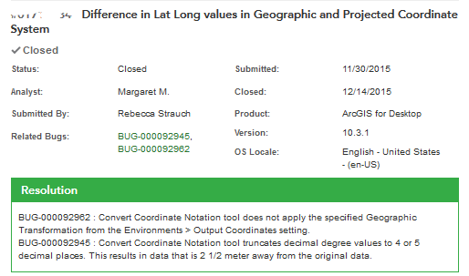

Ken, just as a heads up, there are a couple bugs in this tool.
Looks like these are schedules to be fixed in v10.5 (tentative release early next year last I heard)

Rebecca,
Thank you so much for commenting. I've not checked the position of
the coords provided by the notation tool.
2 meters is a problem for me, so I'll check some of the positions
and, if they are off that far, I'll make a note to change them after
the bug is fixed, so the coords don't get truncated as much.
