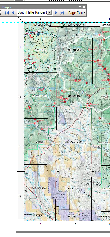

When I set them up to try and match exactly as it is and I do not see the line that can match the tabs . See here ..

The tabs are part of a reference grid (aka index grid), which divides the frame edge into equal parts starting at the corner. The quad index lines are not tied to the frame and do not divide it up into equal parts from the corners. Moreover, the quad index lines are not exactly perpendicular/parallel to the frame. This means the grid and the lines will not match up, and there is no way to edit the reference grid to match the quad lines.
You will either need to draw tabs to match up using graphics (you could start with the index grid and convert it to graphics, then ungroup and edit the result), which won't be dynamic of course, or you may be able to use a custom overlay grid to label the edges with letters and numbers. To do that you will need a polygon feature class with an attribute for the letters and numbers (it may need 2 sets of features and 2 overlay grids, one for the rows and one for the columns). See Adding a Custom Overlay Grid in the help.
