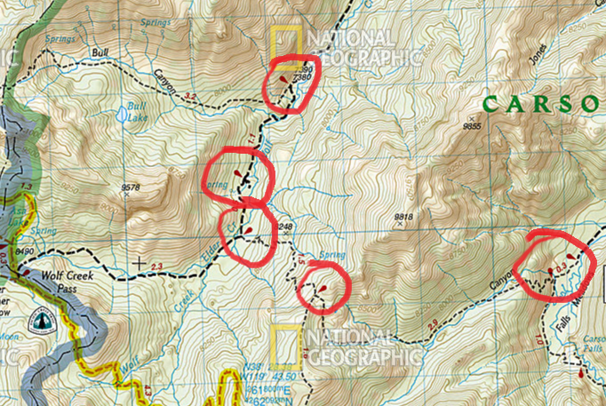

I'm working on a trail map and would like to illustrate trail segments and their corresponding distances. In order to clearly indicate the segments, I would like to use arrows like the attached example. I have created point features where all of the segments begin and end using the intersect tool, but now I would like to figure out how to place arrows like the example (see red circles). Ideally, the arrows should be angled so as to avoid overlapping the linear trail features. Does anyone know how I might be able to do this?

You can use a symbol (or picture marker symbol) and use the rotation setting on the symbols:
The challenge may be in the offset of the symbol to the actual point location. You can use X and Y offsetting in the properties of the symbol, but this does not give correct results when applying rotation.
... and the effect on large rotation angles:
An alternative could be creating rotation angle classes (for instance each 30°) and define a symbol with the proper offset for each symbol.

Thank you for the reply. It looks like the key to making this work is having a field with the rotation angle for each symbol. Correct?
XanderBakker
Esri Esteemed Contributor
Yes, that is correct. However, if you have an offset of the symbol to the point location, you may have to create different classes and define symbols for each class.
