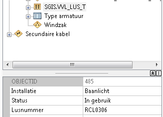

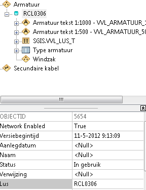

I have one feature class say bulb. This feature class has relationship with on table (Supply). If i am changing the value of the value in the table then the attribute value is being reflected but in the tree view just below the Bulb feature class where the values has also to be updated is not getting updated and hence the values in the Annotation Feature class is also not getting updated.
If  I open the feature  class and try and edit the attribute , then the new values are reflected in the annotation feature class. Can some one help me in this

     I have investigated more on this it is as follow .
      I have one feature class which has a linked table . I link one value from this table in the feacture class . The attribute of the liked table and the feature class get changed but the annotation values is not changing .I am attaching the screen shot of the attribute of feature class and the annotation may be you can have a look Annotation of Feature class.PNGAnnotation on the map.PNGFeature Class Attibute.PNGRelated table.PNG
JayantaPoddar
MVP Alum
Try saving the edits, and refreshing the dataframe.
