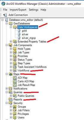

11. WMX Administrator Reconfigure to use the new wmx repo sde gdb
- Geodatabse > data workspaces - https://desktop.arcgis.com/en/arcmap/latest/extensions/workflow-manager/adding-data-workspace-connec...
- maps - https://desktop.arcgis.com/en/arcmap/latest/extensions/workflow-manager/maps-and-versioning.htm
note: might need to export the map, open it in ArcMap, resource the layers to point to new gdb, save mxd and then update the map in the wmx repo
- external properties tables - those shall remain the same, see note below
- queries / reports - those shall remain the same, see note below
- job types - make sure the job type is using the correct data workspace and configuration is fine
- workflows - check the job workflows and make necessary adjustments
note: extended properties configuration does not change once the SQL Server database data owner user of the wmx repo remains the same,
means the fully qualified object names do not change, e.g. db.owner.table
