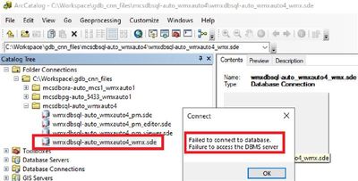

5. Bug: Database connections to SQL Server fail when Microsoft ODBC Driver 18 is installed
Early versions of ArcGIS Pro fail to connect with the Microsoft ODBC Driver 18.
Bug: Database connections to SQL Server fail when Microsoft ODBC Driver 18 is installed (esri.com)

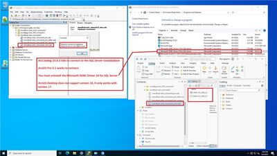

7. Microsoft ODBC Driver 18 for SQL Server
  • if you have ArcGIS Desktop 10.8.2 and ArcGIS Pro 3.1 installed on the same machine,
  • and you want to connect to SQL Server Geodatabases then
  • make sure you have only the Microsoft ODBC Driver Version 17 installed.
  • ArcGIS Pro 3.1 works with Microsoft ODBC Driver Version 18 and 17.
  • but ArcGIS Desktop 10.8.2 works only with Microsoft ODBC Driver Version 17.
