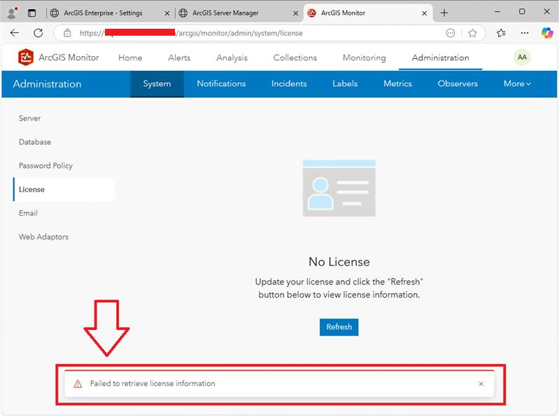

ArcGIS Monitor 2024.1.1 - Failed to retrieve license information

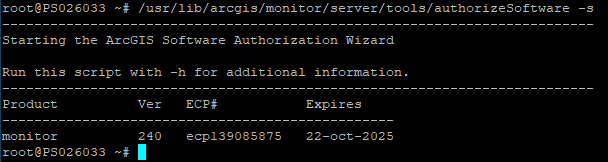

I can check that the license is fine.

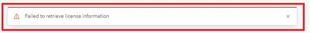

But a warning message keep showing up "Failed to retrieve license information"

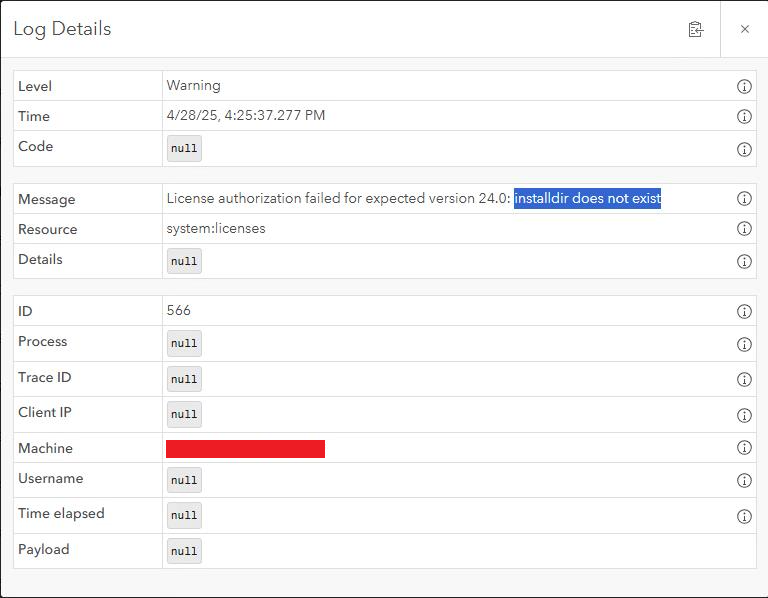

ArcGIS Monitor Logs show the message "installdir does not exist".
enabled debug mode log level in ArcGIS Monitor and tried to refresh the license from the Monitor web app.
I got a few more messages that helped me narrow down the issue.
"Checking license 240 at /usr/lib/arcgis/monitor/server/framework/ESRI/License24.0"

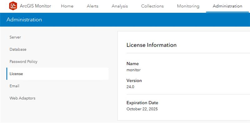

Now, ArcGIS Monitor can validate the license just fine.
