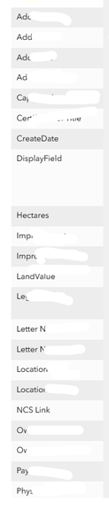

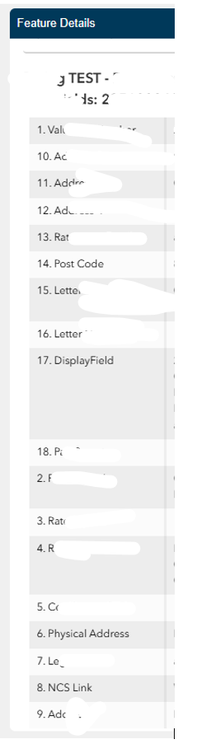

  2. Field order issue – The fields appear in alphabetical order, but we want the main fields to be displayed first. I tried adding number to the field aliases, but it did not work. Please see the screenshots below for reference.

Alphabetical order
Test to add number but it does not work

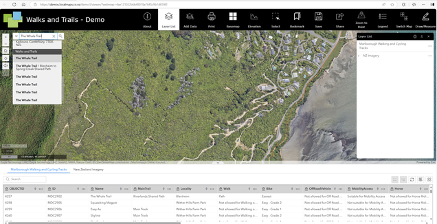

Hi @Aravindh_Rajendran: Many thanks for considering my question. Yes, I will log a case to Eagle Support Team. But I would like to give you more detail using Eagle Local Map testing site Eagleton City Council
For example,
- Go to the "Walks and Trails - Demo" map,
- Search for "The Whale Trail"

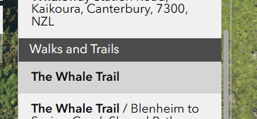

- In Search, click on "The Whale Trail" under "Walks and Trails"

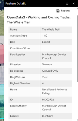

- The search result pop-up is opened, and the fields in the pop-up follow alphabet order
Can you please test whether you can configure the order of fields (using a preferred order) and hide some fields in the search result pop-up?
