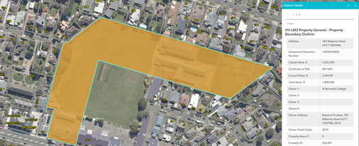

I created a customised popup with a title and text for that layer In MapViewer
 and that works well when you click on the map
I created a Search on a layer, and I enabled “Show Results in popup”.
When I search on that layer in LocalMaps it displays the “raw” details, rather than the nicely formatted pop-up.
Is there a way to display the customised pop-up in the Search popup, rather than the feature details?

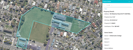

Aravindh_Rajendran
Hello @Marie-LouLabuschagne,
Thanks for raising this, we are working on a fix. The fix would be to honour the pop-up field settings rather than displaying the whole table or raw data. Most likely, the fix will be included in the upcoming patch.
As a workaround, try adding that layer through Data sources and whitelist the fields required. Essentially you have to add your Portal or AGOL as a data provider and then the layer needed for search as a data source. While configuring this, you will have an option to whitelist the fields as required. Once this is done, this data source can be used while setting up a search. Hope this helps.

Aravindh_Rajendran
Hello @Marie-LouLabuschagne This is fixed in 3.2.6.
