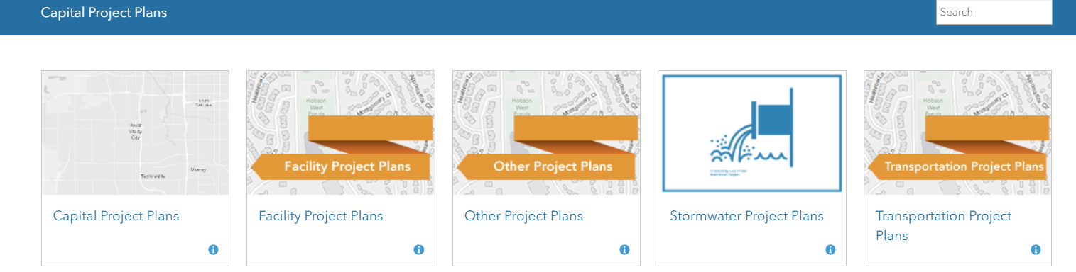

RIght I understand that.  But the Capital Plans App is showing in its own gallery which is redundant.  If a user clicks it, a new window opens with another Capital Prject Plans App gallery.  My other issue is that when I disabled some fields for editing/display in their respective project plans webapps, the image that corresponds to their app in the gallery was lost.  Here is what it looks like now:
The stormwater one is there because I made a screenshot of that image and uploaded it as the thumbnail which is what I will probably do for the others, but I wanted to see if there was a way to avoid this problem.
ChrisFox
If you unshare the Capital Project Plans app with the Capital Project Plans group it won't show in the gallery app. That app doesn't need to be shared with the group.
For the other issue I am not sure why editing the app configuration would change the thumbnail of the item, I have never encountered that before. If you want to get the original thumbnails back you can do the following:
  1. Go to https://www.arcgis.com/apps/MinimalGallery/index.html?appid=28d8f5723e76466987b50b4e57120e97
  2. Click the 'I' info button to open the item details of one of the Project Plans
  3. Right-click the thumbnail and select Save As to save the thumbnail locally
  4. Update your app item with the thumbnail
ChadBunn1
Thank you for the link to the original images.  I also unshared the Capital Plans app from the group and that fixed the other issue.

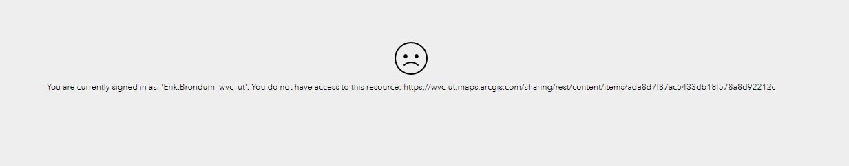

Chris I have successfully deployed the Capital Project solutions but now I am unable to share them with the members of my organization.  I have added them to the appropriate groups and shared the maps and apps with their groups but they are still getting an error message stating that they do not have access to the resources used in the apps.  How can I remedy this?You do not have access to the resources error.
ChrisFox
Hi Chad, In that error message there is an item id at the end of the url. I would recommend checking out that item to see it is shared with the user. Also, in addition to the apps and maps you will want to make sure all the layers are shared with the appropriate groups.
