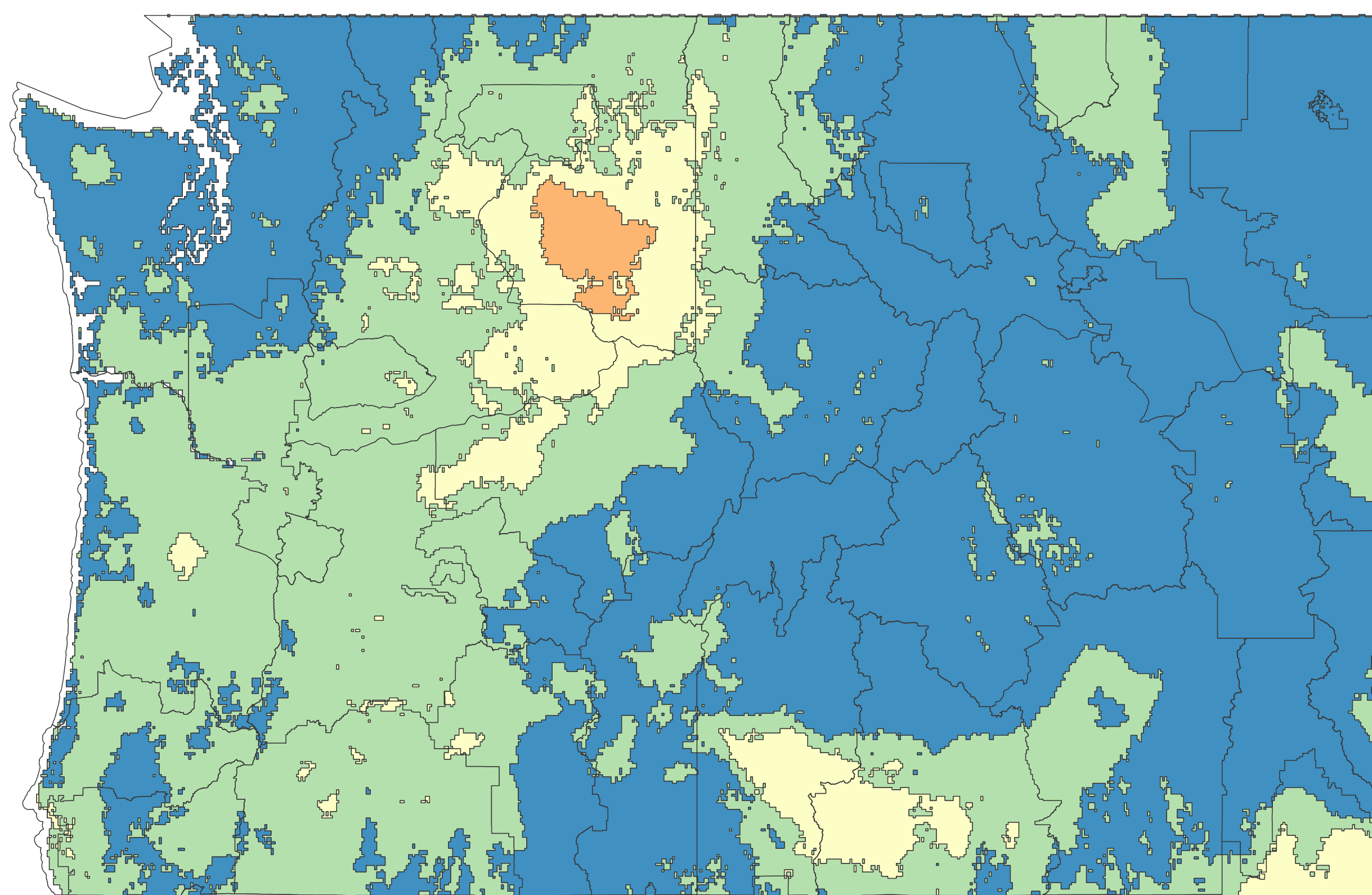

Here's the stylesheet JSON that corresponds to the screenshots below.
  "layers": [
      "id": "Severe Fire Danger Index",
      "layout": {
        "visibility": "visible"
      "paint": {
        "fill-color": [
          "match",
            "get",
            "sfdi_value"
          "LOW",
          "rgba(42 ,131, 187, 1)",
          "MODERATE",
          "rgba(171, 221 ,164, 1)",
          "HIGH",
          "rgba(253, 254 ,190,1)",
          "VERY HIGH",
          "rgba(253 ,174, 97,1)",
          "SEVERE",
          "rgba(215, 25, 27,1)",
          "rgba(0, 0, 255, 0.5)"
        "fill-opacity": 0.7
      "source": "sfdi",
      "source-layer": "public.sfdi_ignis_zone",
      "type": "fill"
  "sources": {
    "sfdi": {
      "maxZoom": 14,
      "minZoom": 0,
      "tiles": [
          "https://ourtileserveraddress/public.sfdi_ignis_zone/{z}/{x}/{y}.pbf"
      "type": "vector",
      "volatile": true
  "version": "8"
Attaching a screenshots of what the tiles should look like...

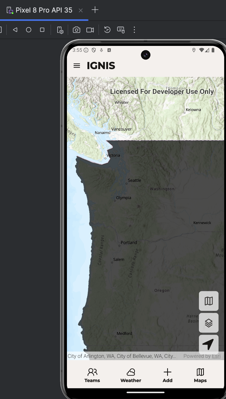

This is how it currently renders in the Android emulator...
GuntherHeppner
@IgnisDev - the Kotlin & Swift SDKs don't support match statements in JSON stylesheets and there is no plan to support them in the future.
In terms of solutions/workarounds, you might want to look at the tile spec that Esri supports, using:
- Esri's vector basemaps
- the Esri Vector Tile Style Editor
