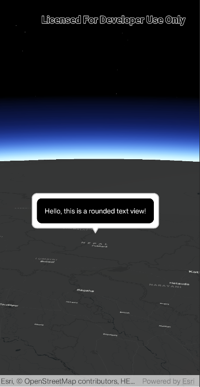

How does callout remove the default dialog shape background,RuntimeSdk200.2.

In 100.15.1 version, for example, you can call "calloutStyle. SetLeaderLength (0)"  to remove the arrow, but in 200.2 SceneView, didn't see the corresponding method.
In the screenshot above, I only want to keep the black background part and remove the white background outside.

@skyfendskyfend - thanks for clarifying. The current callout at 200.x does not support custom styling. We have logged an enhancement request to support this in an upcoming release.
