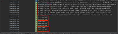

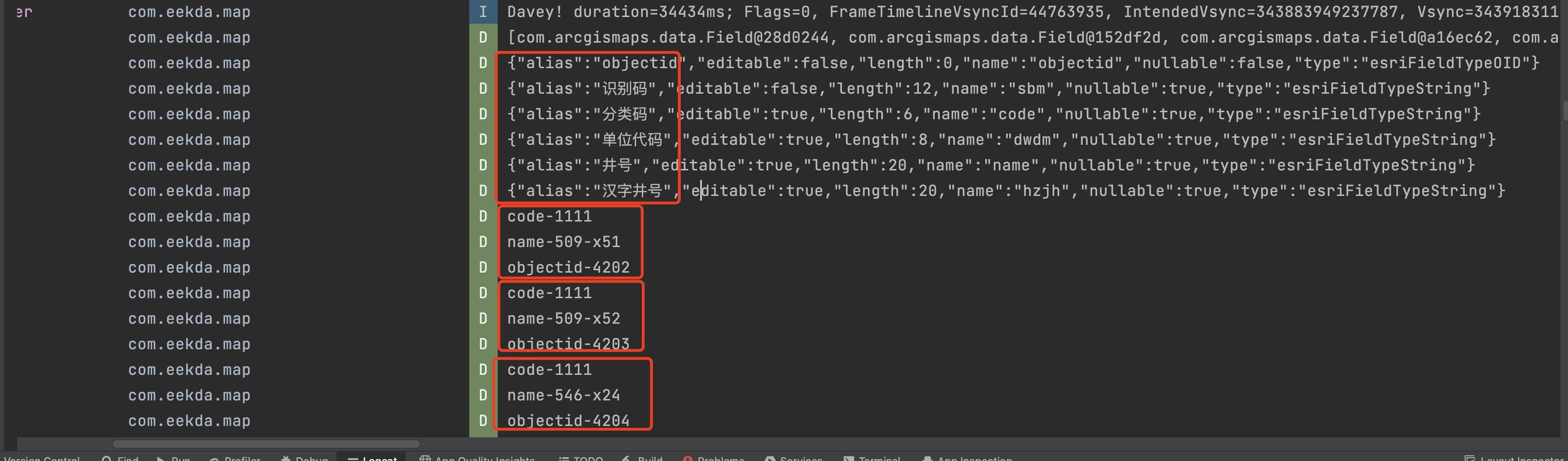

For example this image:
This FaetureLayer have fields:"objectid","sbm","code","name","dwdm","code","hzjh".But when I run queryFeatures or selectFeatures,only return fields "code","name" and "objectid".
I found that the outFields in QueryParameters is not set by internal methods.
How can I get the full attribute result featrues?
