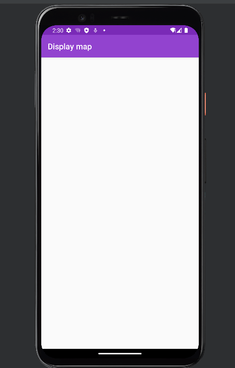

New to android dev: I am having issues displaying the git hub kotlin samples using the android studio emulator. As far as I know, my dev environment is configured correctly (API_KEY is set, etc...) but I am wondering if this is common and perhaps there are some solutions to look for that will help solve this problem
Any advice appreciated, thank you.
Here is my console code after running the kotlin sample 'display-map' https://github.com/Esri/arcgis-maps-sdk-kotlin-samples/tree/main/display-map

We will need more information on how you're running the app and the device specifications. The log message doesn't help determine the issue you're facing, so I can help by providing a few guidelines for running the app. Feel free to respond to the thread if you still find the issue. Follow the steps to launch a display map sample:
  1. Open the project at the root level directory: "arcgis-maps-sdk-kotlin-samples/"
  2. Add the API key using the global "gradle.properties" file. (Instructions)
  3. Go to File-> "Sync Project with Gradle files". Open the "Build" tab and keep an eye on the log messages to verify the project builds with success.
  4. Choose a sample ("Display Map") and click run. If issues still persist, please test on a physical device to eliminate any emulator issues.
jcziesch
Hello, thank you for the input and I apologize for the late response. I verified the steps you mentioned and though I have not been able to test a physical device, everything else has been verified.  Android Studio cannot access repositories necessary to build/use ArcGIS Kotlin applications due to various network and security protocols. Because we operate from our network access/requests are issue, I am looking at offline repo options as mentioned in the Kotlin SDK documentation.
