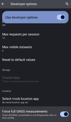

  • Option 2:
Enable “Force Full GNSS” (Developer Options) You can enable developer options to “Force full GNSS measurements” (no duty cycling) to ensure the device uses maximum power and tracks all satellite constellations/frequencies.
While testing accuracy logs, ensure Improve Location Accuracy is enabled: Link
