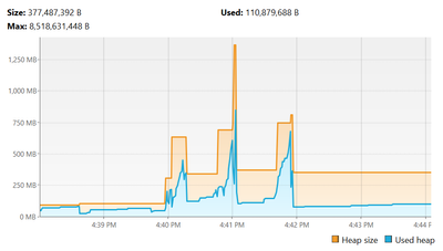

Firstly, I investigated the memory usage of the JVM, thinking perhaps some large objects are not being garbage collected. I mapped our memory usage in VisualVM as seen here:JaredFaulk_0-1681484882344.png
However, everything is performaing as expected. Memory usage spikes for each new calculation, and then all unreferenced objects are garbage collected at the end of the calculation. I also checked our metaspace usage, but that never exceeds 50MB (so metaspace is not the issue). I therefore am running into some form of native memory leak.

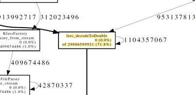

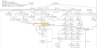

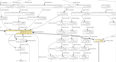

To further chase this leak I discovered this blog [here] and [here] which seemed to have a very similar obscure memory leak. The blog posts in summary: other large java systems had a native memory leak that could not be found, and both blogs successfully debugged and patched the leak using a tool call jemalloc (spoiler, the culprit was some form of Inflator/Deflator Object used for compression/decompression not being closed) Jemalloc is essentially a memory allocator exactly like malloc, but with further debugging functionalities added. I replaced the JVM's default malloc to use jemalloc and then created memory usage reports in a tree structure using jeprof (a built in reporting tool with jemalloc). Now here is where my debugging is hitting a road block.
Here are the reports generated (zoomed into the most likely culprits):
Zooming into some weird potential culprits:
And further weirdness:
Here is where I need some help. I am interpretting these results based solely off of the other examples I have seen from similar results (i.e. each blog post I link shows an example, I could not find documentation detailing interpreting this graph). From my understaning, the bottom percentage is the percentage of total memory used from my application from that method. Which then points to 90% of my memory used at RT_Vector_setElementRemovedCallback, and 70% of that is in lerc_decodeToDouble (?). I found the LERC project, which has a github repository: Lerc Repository Then I also found the 'decodeToDouble' function which is here: decodeToDouble.
MY QUESTION IS:
Does this appear to be a Esri memory leak in the SDK I am using? Or am I interpreting these results wrong? If this is a memory leak, this is potentially a serious bug in the Java Maps SDK. Thank you for your feedback.
