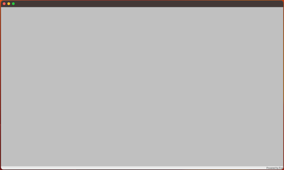

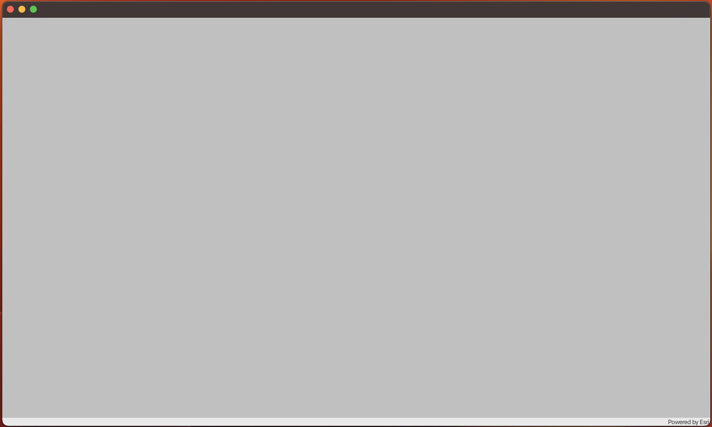

When trying to use a base example to simply show a base map, the window pops up but the map never shows.

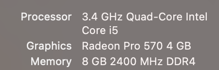

I'm currently on a Mac running Ventura with the below specs
I'm running in IntellJ, with Gradle configuration with the Azul zulu JDK17
Any help or insight would be great

I switch back to the original Mac to go through the same steps and I get the following error
> Configure project :
Project : => no module-info.java found
> Task :run FAILED
2023-05-05 15:19:39.412 java[48567:646696] *** Assertion failure in -[_NSTrackingAreaAKViewHelper removeTrackingRect:], _NSTrackingAreaAKManager.m:1623
2023-05-05 15:19:39.474 java[48567:646696] *** Terminating app due to uncaught exception 'NSInternalInconsistencyException', reason: '0x0 is an invalid NSTrackingRectTag. Common possible reasons for this are: 1. already removed this trackingRectTag, 2. Truncated the NSTrackingRectTag to 32bit at some point.'
*** First throw call stack:
        0   CoreFoundation                      0x00007ff817d561ba __exceptionPreprocess + 242
        1   libobjc.A.dylib                     0x00007ff81787c42b objc_exception_throw + 48
        2   Foundation                          0x00007ff818c2beb8 -[NSCalendarDate initWithCoder:] + 0
        3   AppKit                              0x00007ff81b4213a5 -[_NSTrackingAreaAKViewHelper removeTrackingRect:] + 190
        4   libglass.dylib                      0x000000012b1f74e9 -[GlassViewDelegate setFrameSize:] + 361
        5   libglass.dylib                      0x000000012b1fcd68 -[GlassView3D setFrameSize:] + 88
        6   AppKit                              0x00007ff81adb05e1 -[NSView setFrame:] + 347
        7   libglass.dylib                      0x000000012b1fcdc5 -[GlassView3D setFrame:] + 69
        8   AppKit                              0x00007ff81adc13e4 -[NSView resizeWithOldSuperviewSize:] + 694
        9   AppKit                              0x00007ff81adc0d17 -[NSView resizeSubviewsWithOldSize:] + 499
        10  AppKit                              0x00007ff81ada0496 -[NSView setFrameSize:] + 1460
        11  AppKit                              0x00007ff81adb05e1 -[NSView setFrame:] + 347
        12  AppKit                              0x00007ff81adc13e4 -[NSView resizeWithOldSuperviewSize:] + 694
        13  AppKit                              0x00007ff81adc0d17 -[NSView resizeSubviewsWithOldSize:] + 499
        14  AppKit                              0x00007ff81ada0496 -[NSView setFrameSize:] + 1460
        15  AppKit                              0x00007ff81adbf120 -[NSThemeFrame setFrameSize:] + 464
        16  AppKit                              0x00007ff81adbe82b -[NSWindow _oldPlaceWindow:fromServer:] + 831
        17  AppKit                              0x00007ff81adbd2ca -[NSWindow _setFrameCommon:display:fromServer:] + 3045
        18  libglass.dylib                      0x000000012b1eeacf -[GlassWindow(Java) _setFlipFrame:display:animate:] + 239
        19  libglass.dylib                      0x000000012b1ee5cc -[GlassWindow(Java) _setWindowFrameWithRect:withDisplay:withAnimate:] + 268
        20  libglass.dylib                      0x000000012b1ee81b -[GlassWindow(Java) _setBounds:y:xSet:ySet:w:h:cw:ch:] + 571
        21  libglass.dylib                      0x000000012b2082fe Java_com_sun_glass_ui_mac_MacWindow__1setBounds2 + 446
        22  ???                                 0x0000000117914051 0x0 + 4690362449
        23  ???                                 0x000000011790fe9f 0x0 + 4690345631
        24  ???                                 0x000000011790fe9f 0x0 + 4690345631
        25  ???                                 0x000000011790fe9f 0x0 + 4690345631
        26  ???                                 0x00000001179102fb 0x0 + 4690346747
libc++abi: terminating due to uncaught exception of type NSException
FAILURE: Build failed with an exception.
* What went wrong:
Execution failed for task ':run'.
> Process 'command '/usr/local/Cellar/openjdk/19.0.2/libexec/openjdk.jdk/Contents/Home/bin/java'' finished with non-zero exit value 134
I might try to use the same Azul JDK 11 version to see if the higher JDK is the problem...or just switch to Nasa Worldwind
