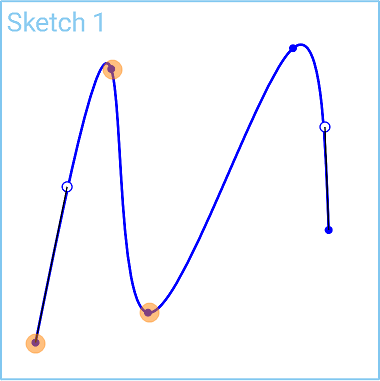

Hi,
I'm currently working on a product that need to generate spline based on a set of point. I was wondering if there was a way to generate a spline with ArcGIS, or if I absolutely need to project my point and calculate my spline from the projected point ?
Example of a spline I need to do:
Thank you

DavidLefaivre
Hi Mark,
Thank you for your fast answer. From my poor understanding on cubic spline (I'm not that good in math), a cubic spline will take a set of points and a speed and calculate the correct curve according to that data. CubicSpline seem to draw the curve I need, but I still need to make the correct calculation to determine the curve to draw.
If cubic spline is not available in Esri, than CubicBezier is a good work around for my case.
Regards,
