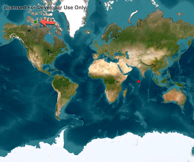

Using your code, I switched the line type to a Geodesic (shortest distance between 2 points over the surface of the Earth) and the new point appeared having travelled over the pole.

 You can see the green dot in my app which went over the pole.
I went a little further and increased the number to 40075000 which is roughly the circumference of the earth and the 2 dots where "fairly" close to each other.  Therefore the point went over the North Pole, the South Pole before coming back to where it started.
Does this help?
