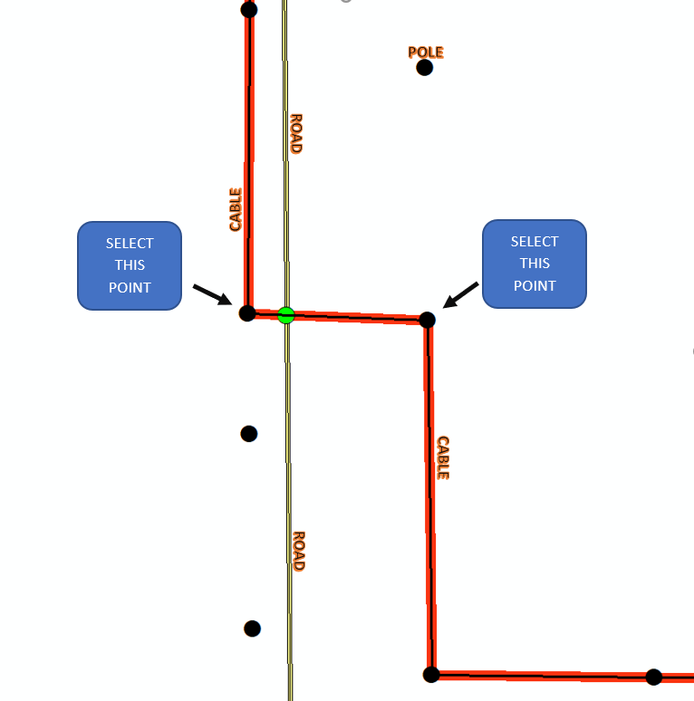

Is there a way for me to select points that share a line with a vertex?  I'm trying to identify poles that are connecting cable going over the road.  Seems simple enough but I have yet to find a resolution.  Any help would be greatly appreciated.

Hello Jennifer,
I can't think of any out-of-the box solution, but you may be able to do some sort of manual or Python-automated selection process. Does your cable line ever back-track? If not, you may be able to use some sort of logic like this:
1) Get the objectID (or some other unique identifier) of the line feature the point sits on.
2) Select all points that intersect that line.
3) From the point selection, use a tool such as Near to find the nearest point to your road intersection point.
It may take some work but that's the closest thing I can think of off the top of my head.
Best of luck!

If you have the correct license, you might  be able to turn your vertices to points and then perform a topology between those new points and your pole points.
Feature Vertices To Points—Data Management toolbox | ArcGIS Desktop
Converting vertices to point features—Help | ArcGIS Desktop
That should just about do it....
