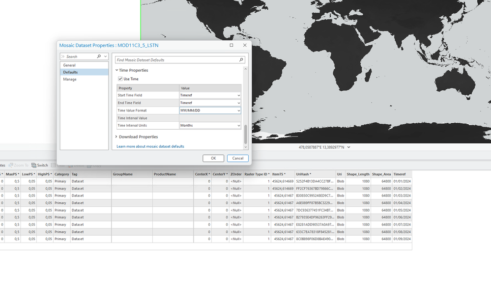

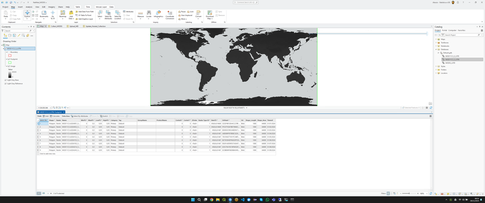

  • added the "Timeref" field to the mosaic dataset and populate it with date values (YYYY/MM/DD)
  • Time enabled the mosaic dataset properties in ArcGIS Pro, checking the Time option and selecting my Timeref field
  • Uploaded on AGOL using Python API (as an IMAGE_COLLECTION)

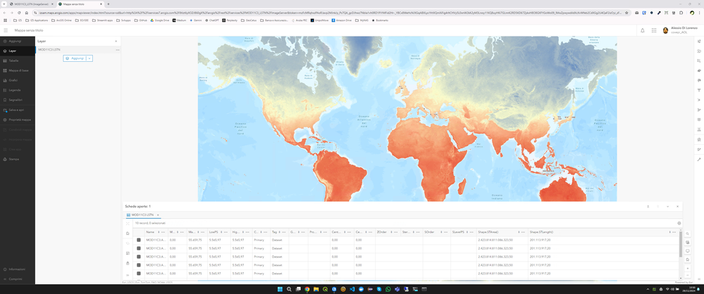

Result: the Timeref field is not in the attribute table of my Hosted Dynamic Imagery Layer and the collection is not time enabled.
What's wrong in the above steps?
I tried also uploading the MDs with ArcGIS Pro (using the "Create Hosted Imagery" button, in the Imagery tab) but nothing changed. Same thing if I create a Tiled Imagery Layer, although I need the "GetSamples" functionality.
The goal is to host the timeseries on AGOL, feed it with new data every month using Python API and use it through  JS applicationsPython code to upload MD on AGOLPython code to upload MD on AGOLMD with its attribute table (added Timeref field)MD with its attribute table (added Timeref field)MD properties (Time enabled)MD properties (Time enabled) No Timeref field in the AGOL collectionNo Timeref field in the AGOL collection
