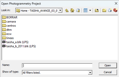

JairoCordero
Hello Cody,
I tell you that I am working with aerial photographs for a photointerpretation, and I have already created the mosaic, but I cannot yet use it for the stereo.
This is where I am stopped and I cannot move forward because I do not know how to construct the stereo model to begin the photointerpretation.
In ArcMAP there is an extension called stereo analysis, where the photogrammetric block can be imported to be used
so those are the ".blk (LPS)" file types that I need to make but in ArcGIS Pro

JairoCordero
Hello, I tell you that I could not do it the way you indicated, since LPS does not allow me to export to MATCH-AT format.
I created the data set mosaic, now I want to know how to build the stereo model. Greetings
