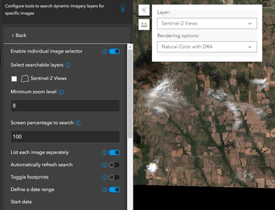

@GuenterDoerffel I am working with the imagery viewer apps, but am not seeing the option to find images by date.  See screen shot and configurations below.  Is there a way to enable this in the updated viewer?  Thank you!
GuenterDoerffel
Megan,
To achive this, you have to enable "Individual Image Search", specify the Sentinel-Layer and the AquisitionDate Field. I have created and attached a short video that might be easier to follow than a lengthy text. Plus the dummy app shown in the video will be available for a few days. The control with the 3 vertical bars opens the UI to select a specific date available in the extent chosen.
Hope this helps!
G.
MeganEngel
Perfect! I totally missed that radio button!
