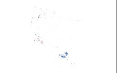

I've been trying to execute land cover classification using deep learning in ArcGIS Pro with Landsat-8 data to no avail. The results look like incomplete and I have been wondering what I did wrong. I started off with multilabel classification attempt, but it did not manage to classify anything fully. Just very patches here and there despite few hundreds of training data created with 'Training Sample Manager'; refer to the screenshot below of the classified image and the real Landsat-8 image
The classified patches overlay the Landsat-8 image perfectly and is accurate but...why is it in patches like that and not classify the whole image?

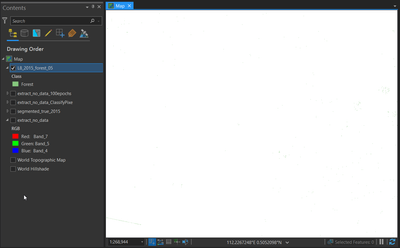

So I thought, maybe it can only handle 1 class label at a time....so I made a single 'Forest' class in the Training Sample Manager, Export Training Data for Deep Learning and train the data in the Jupyter Notebook with the codes I extract from the technical talk 'Geospatial for Deep Learning'. Then using Classify Pixels with Deep Learning tools as outlined. In all instances, the tool took more than 3 hours. For this single class, the result is worse off...practically nothing was generated except some stray pixels; refer below.  

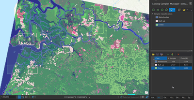

  1. Capture training samples that are representative of your regions of interest. eg:
    Above is the training data that I executed.

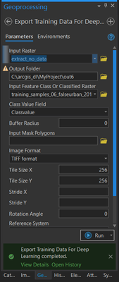

  2. Ensure the output image format for your 'Export Training Data for Deep Learning' GP tool is Tiff. your metadata format should be classified tiles.
             Yes. The training datasets are exported as 'Classified Tiles'

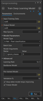

  3. When filling in the parameters for the 'Train Deep Learning Model' tool , set your model type to u-net.Ensure you set ignore_classes = 0 ( in the model arguments section).
    2021-04-10 10_04_04-.png                                                                                  I was using the Jupyter Notebook for this but maybe this is a good option
I have a CUDA GPU installed and the last time I train the U-Net model in Jupyter Notebook, it ran out of memory a few times. There are intermittent occasion where the GPU seemingly works fine and that's when I get the model definition to classify the pixels; is there any specific way to maximize the usage of GPU. And I am curious as to how this process can be done in Jupyter Notebook.  I'm quite new to deep learning but I'm slowly taking everything in.

Landsat data should not be 32 bit floating point. At what point did it get converted? you can apply a stretch function to convert it to 8 bit, and then do all your processing in 8 bit space.
I also noticed you forced a learning rate (for training). Any particular reason? The stride size is blank above - I'd recommend having some overlap. Regarding running into out of memory issues, with a batch size of 2, and tile size of 256, you shouldn't run into that issue. Which GPU do you have?

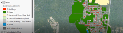

Hi @VinayViswambharan , thank you for your help with this issue. I am having a very similar issue where the UNET model type does not classify the entire raster image. The prediction from the classify pixels tool outputs a very sparsely classified image with only two out of 10 classes mapped. It appears to be a very similar issue to @Anonymous User.  The only difference is I am not using Landsat data but rather a georeferenced drone image. The image is an 8 bit unsigned three band raster. Additionally, I exported the training data setting the output to tiff and classified tiles. Do you happen to know if there is an obvious solution to this?  Thank you!
