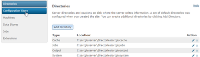

Sorry, what I'm wondering about are the directories and config-store paths, i.e.:
Are they using forward or backslashes, (C:/arcgisserver/directories/arcgisoutput)?
WarrenMedernach

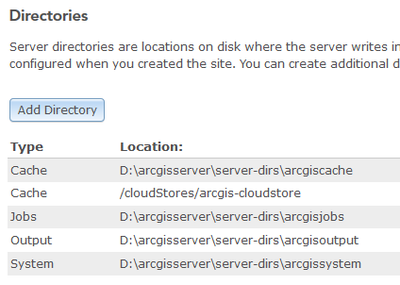

Aaaah I see, here's some screen caps, albeit, I'm not sure what the cloudStores/arcgis-cloudstore Cache is or where it came from?  I don't recall seeing that before?
JonathanQuinn
Esri Notable Contributor
Yeah, that guy is the problem. It's a cloud based cache store, (AWS S3 bucket or Azure BLOB container). Can you edit the directory to see if the information related to how it was registered is familiar? The restore sees that forward slash and thinks the backup is from a linux environment. You may be able to unregister it, restore, then re-register it with the same name so existing services that use it can still access the cache, if any are configured to do so.
WarrenMedernach
Thanks for the info @JonathanQuinn .  I can't seem to find a way to 'unregister', and it won't let me delete it.
JonathanQuinn
It may not let you unregister because it's in use. Do you have any cached services? If so, I'd check to see which cache directory they're configured to use.
WarrenMedernach
Thanks for the assistance @JonathanQuinn
I remapped the cache folder to the few services referencing that cloud store and was then able to remove the data store and proceed successfully with the restore.
JonathanQuinn
If you're open to do it, I'd suggest contacting Support and log a bug. The logic to figure out if it's a backup from a Windows site vs Linux site is fairly... simple. It checks whether any directory paths contain / during a restore. If you directories are using C:/arcgisserver/... or, in your case, using cloud storage, this check will fail. Server should be smarter about how to figure out where the incoming site is coming from.
