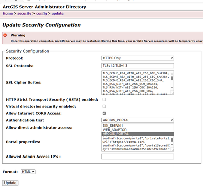

Hi @Sunnywaygis, you need to go to https://dns.com/server/admin/security/config select update and set Authentication tier to GIS_SERVER and then after this you just federate again.
Regards
Henry

Thanks Henry, One of the federated GIS server is also hosted server, other one being image server.
Will this workflow you suggested still works or there are any other considerations.
Thanks for your time.
HenryLindemann
Hi @Sunnywaygis, yes, it is the same procedure, one thing I forgot to mention is that if your items don't reflect after the federation, then you will need to go to portaladmin and unfederated and then federate again, this will then resolve any missing items and pull them into portal.
Regards
Henry
