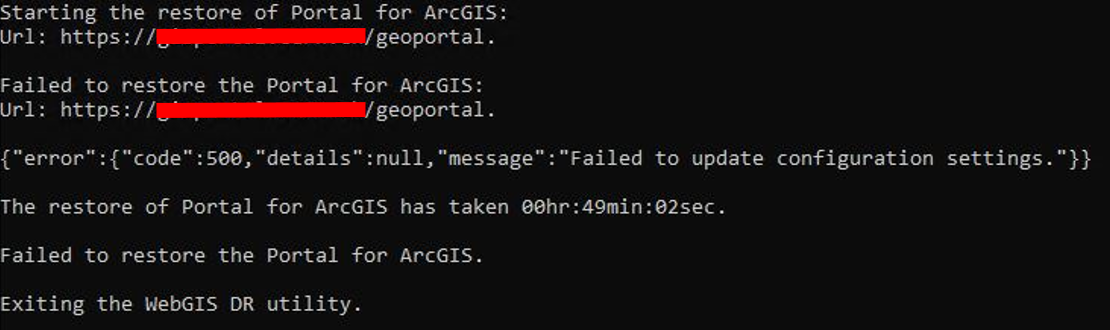

Hello,
Since I upgraded from 10.9.1 to 11.0, my webgisdr restore tests start failing for Portal for ArcGIS with the error message "Failed to update configuration settings.":
Here is the relevant Portal for ArcGIS logs:

I then tried manually to 'importSite' rather than the full webgisdr process: same issue.

This is likely the same problem that causes BUG-000152888 Error, "Upgrade failed. Failed to update configuration settings" upon upgrading the Portal for ArcGIS to 11.0 since the code paths are very similar during importSite and upgrades. This will be included in an upcoming security patch.

FYI, "Portal for ArcGIS Security 2022 Update 2 Patch"  including the fix for BUG-000152888 fixed my issue .
Restauration is now fully fonctional ! What a relief 🙂
