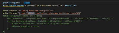

The only difference I see between you and I, is that I use my own fork of ArcGIS DSC because of issue 132:
https://github.com/Esri/arcgis-powershell-dsc/issues/132
I prevent DSC from configuring the hostname:
I had open a BUG regarding this issue:

I'm curious if you've commented-out the related hostname.properties section in the ArcGIS_ServerUpgrade.psm1 file as well:
https://github.com/Esri/arcgis-powershell-dsc/blob/master/Modules/ArcGIS/DSCResources/ArcGIS_ServerU...
If not, there is an additional indication that the hostname.properties file being added during the upgrade may be at fault, especially in light of your additional testing results.

NicolasGIS
Honored Contributor
Well spotted. I was about to test 😉.
Let me give it another run with this modification and I come back to you !
