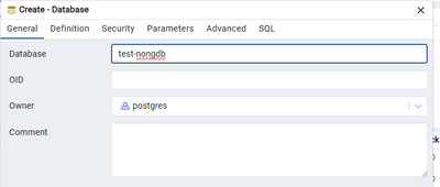

Ok, so you create the PostgreSQL database (non-Enterprise GDB) outside of ArcGIS Pro. That can be done in pgadmin.
It looks like you are using the "template" database that is created with the PostGIS install.
You need to create a new database in PostgreSQL. There are MANY different ways to do this.
Here is how I do it in pgadmin: you must be logged in as the admin account (in my case is postgres)
1. Right Click the PostgreSQL instance name --> Create --> Database
2. provide a name and leave the owner as "postgres"
On the "Definition" tab, you use the "postgis_35_sample" database as the template. You can also set a tablespace location, if desired.
Then hit save.
3. In ArcGIS Pro, make a connection to that new DB and create a new FC, just call it test.
I usually create a database user, using the GP tool in Pro: https://pro.arcgis.com/en/pro-app/latest/tool-reference/data-management/create-database-user.htm, and have that user own the data.
Hope this helps clear up any confusion.
--- George T.
RachelMba1
Absolutely worked! @George_Thompson. Thank you very much.
