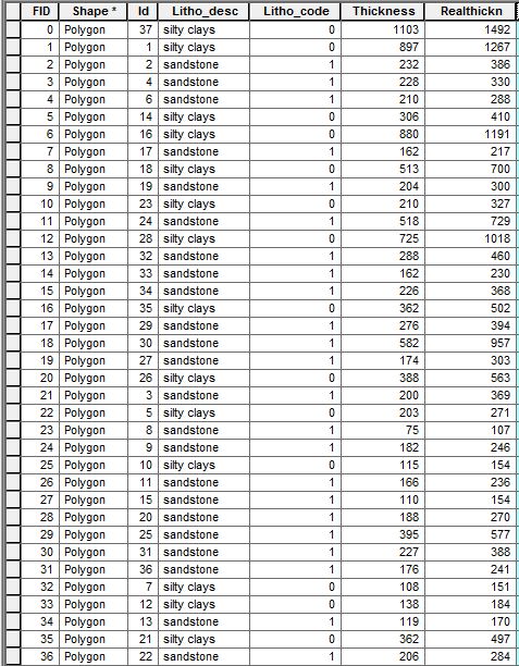

Here the table,

Is the ratio of real thickness to thickness the same? What results do you get for those since there is no point in stretching a polygon unless it is so?  And in your case you would only need to calculate the new end of a line in a cumulative manner then use a buffer each segment using a square-end buffer once you have those
ADDENDUM
 using numpy to expedite the process and looking at your first four... there is no obvious discernal communality between observed and measured.
a
array([1103,  897,  232,  238])
>>> b
array([1492, 1267,  386,  330])
>>> a/b
array([ 0.739,  0.708,  0.601,  0.721])
>>> b/a
array([ 1.353,  1.412,  1.664,  1.387])
>>> a-b
array([-389, -370, -154,  -92])
>>> (a-b)/a
array([-0.353, -0.412, -0.664, -0.387])

Thank for your help:
1- The ratio in not the same, it's calculated according to the slope mean for each layer. cf last picture
Thanks to trigonometry i can guess the real thickness according to the slope.
