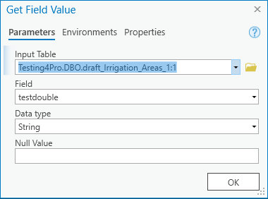

However, it seems that it WILL pass a 0 as a string:
Which then calculates back to a double field just fine, and will automatically cast it to double, even when it is 0.

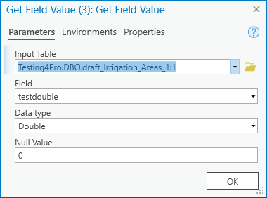

Putting 0 in the null value field works for me:

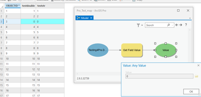

I have tested with the above config using both a text input field and a double input field.  As long as I set it up in the Get Field Value tool as Double, with Null Value 0, it works as expected.
With 2 selected:
With 0 selected:

I can't believe I didn't try that. That did it - thanks so much!
