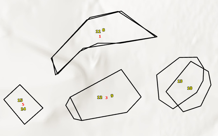

Example (yellow polygons labeled with yellow OBJECTIDs, black outlined Polygons labeled with black OBJECTIDs, groups not symbolized but labeled with red OBJECTIDs. Polygons without group don't have enough overlap.)

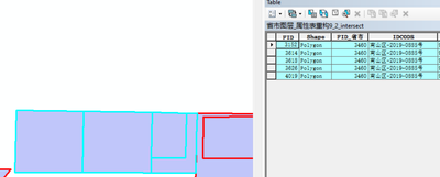

Hi Johannes,
     Great point! We adopted your strategy and did make some progress. But we also found out that some identical polygons (polygons with exactly the same shape and area overlapping together) somehow did not get grouped at all.

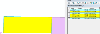

     For instance, the three polygons with highlighted yellow color in pic 1 (南山区-2021-0588号, 南山区-2020-0268号,南山区-2019-0885号) overlapped with each other 100%. They additionally overlapped with some smaller polygons (see pic 2). However, the tool "intersect" only returned intersected results of these three polygons with those smaller polygons, rather than additionally returning intersected results among the three polygons themselves. Any hints to solve this? Thanks in advance!
Pic 1: the three polygons overlapping each other 100% but not grouped into a family by the intersect tool
Pic 2: Take polygon 南山区-2019-0885号 for instance, the intersect result only returned its intersected areas with small polygons rather than returning its intersected results with 南山区-2021-0588号 and 南山区-2020-0268号 as well.
