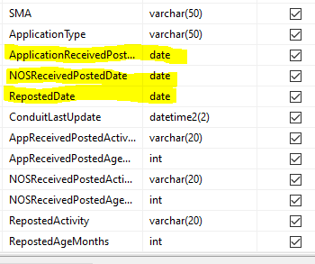

by Anonymous User
Not applicable
Yes. I meant to initially include this information. The highlighted 'Date'  fields are dropping off using method one. They are maintained in method 2.

Your second option, of not using the shortcut but the tool is the way to go.  It appears from the script
"C:\... Your_Install_Folder ...\Resources\ArcToolBox\Scripts\XYTableToPoint.py"
That it use cursors to complete the work, so I would expect a better handling of dates and times.  There are lots of threads on the web about how to handle datetime and csv outputs, many are language specific and many suggest converting to text fields first.  I would skip doing workarounds and let the arctoolbox tools/scripts handle the work
